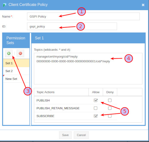

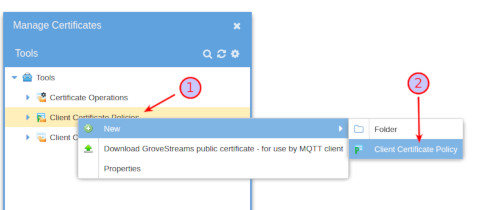

Create a new Policy:
1. Right-click Client Certificate Policies or a subfolder for the new Policy location and ...
2. Select New - Client Certificate Policy
Create the Publish and Subscribe Set:
1. Name the Policy
2. Set the Policy ID. IDs are used mainly by the GS API library
3. Click + to create a new set
4. Copy and paste the topics below into the policy Topics field:
manage/cert/myorg/cid/*/reply
{yourOrgUid}/cid/*/reply
5. Enable Publishing and Subscribing for the topics above
Reply topics need both Publish and Subscribe capabilities because the Pi will Subscribe for a reply and the GS MQTT server will Publish the reply. The GS MQTT server will check to ensure the certificate policy allows for the publish of the reply.

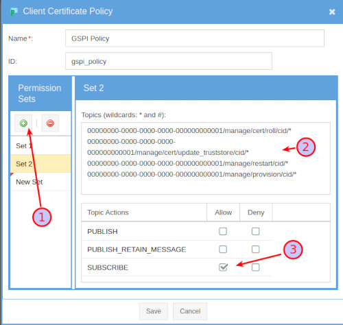

Create the Subscribe Set:
1. Click + to create a new set
2. Copy and paste the topics below into the policy Topics field:
{yourOrgUid}/manage/cert/roll/cid/*
{yourOrgUid}/manage/cert/update_truststore/cid/*
{yourOrgUid}/manage/restart/cid/*
{yourOrgUid}/manage/provision/cid/*
3. Enable Subscribing for the topics above

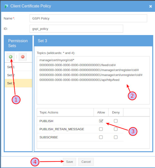

{yourOrgUid}/feed/cid/#
{yourOrgUid}/manage/cert/register/cid/#
{yourOrgUid}/manage/cert/unregister/cid/#
{yourOrgUid}/api/http/feed
3. Enable Publishing for the topics above
4. Click Save to save and close the window

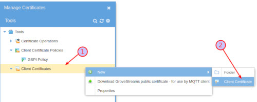

2. Import Certificates
This section lists the steps to import X.509 certificates and assigning their policies. The entire certificate chain, including the root, needs to be imported into your GroveStreams organization. A purchased certificate may include a bundle certificate which may be imported. Bundles usually contain the entire chain above the device certificate. Certificate Authority (CA) certificates, including bundles, only need to be imported once into an organization and can belong to many organizations. A device certificate can only belong to one organization. It is highly recommended that each device have its own device certificate.
Ideally, only the device certificate should reside on the Pi and the CA certificate (private key and public key) would be imported from somewhere else. This tutorial is generating and storing both certificates on the Pi.
Open the MQTT certificates window:
1. Right-click Client Certificates or a subfolder to import the certificates into and ...

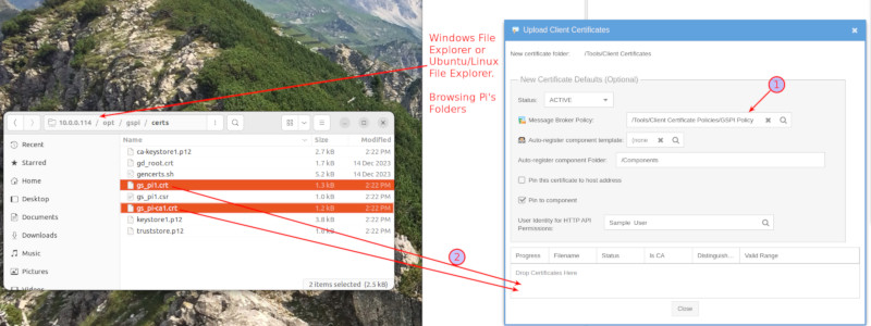

Import certificates:
1. Select the Message Broker Policy that was created earlier. All New Certificate Default settings will be assigned to imported certificates.
2. Open a file explorer window for the Pi and navigate to the Pi's /opt/gspi/certs directory and drag device certificate,gs_pi1.crt, and the CA certificate, gs_pi-ca1.crt, onto the import window. The import occurs as files are dropped.

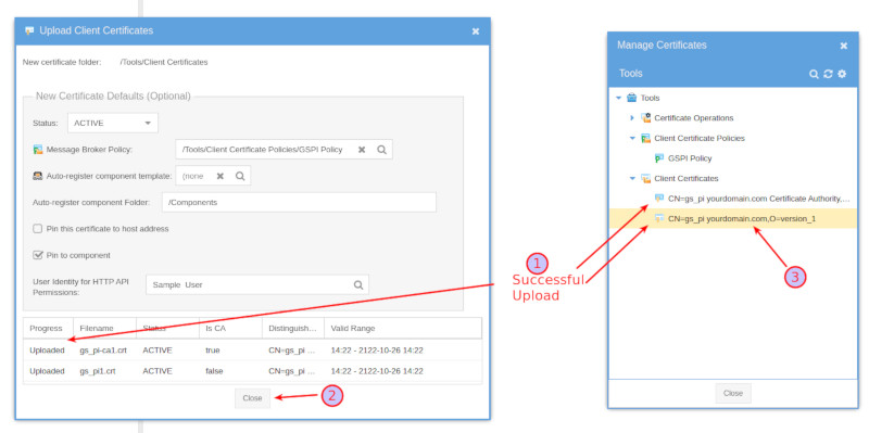

View imported certificates:
1. Ensure the import progress is Uploaded and the new certificates appear within the Manage Certificates window
2. Close the import window
3. Double-click a certificate to view or edit it

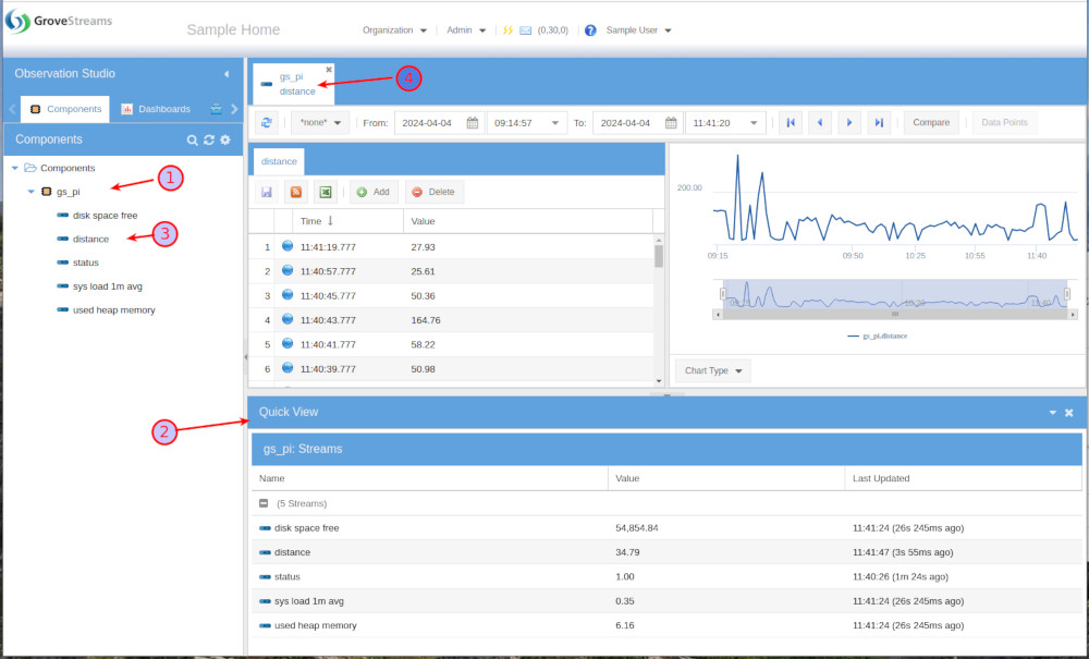

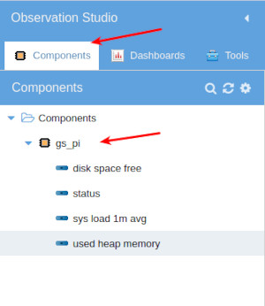

- A new gs_pi component, along with its data streams, will appear within Observation Studio under the Components tab:
Congratulations! You have successfully used MQTT to communicate with your Pi fromGroveStreams.

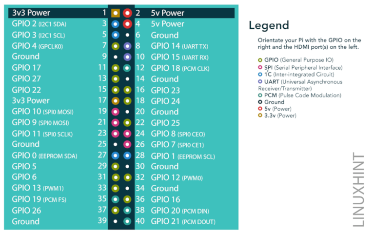

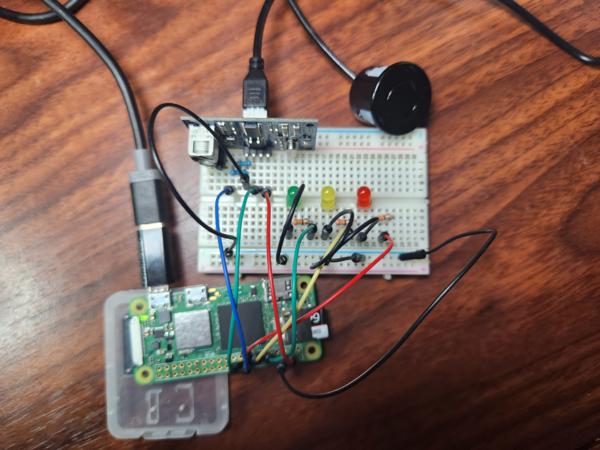

Step 6: Enable the JSN-SR04T Sensor and LEDs (Optional)
1. Edit /opt/gspi/gspi.properties. Sudo or su will be needed as this file has been secured: sudo nano /opt/gspi/gspi.properties2. Change ENABLE_DISTANCE_AND_LED_LOGIC to true
3. Power down pi

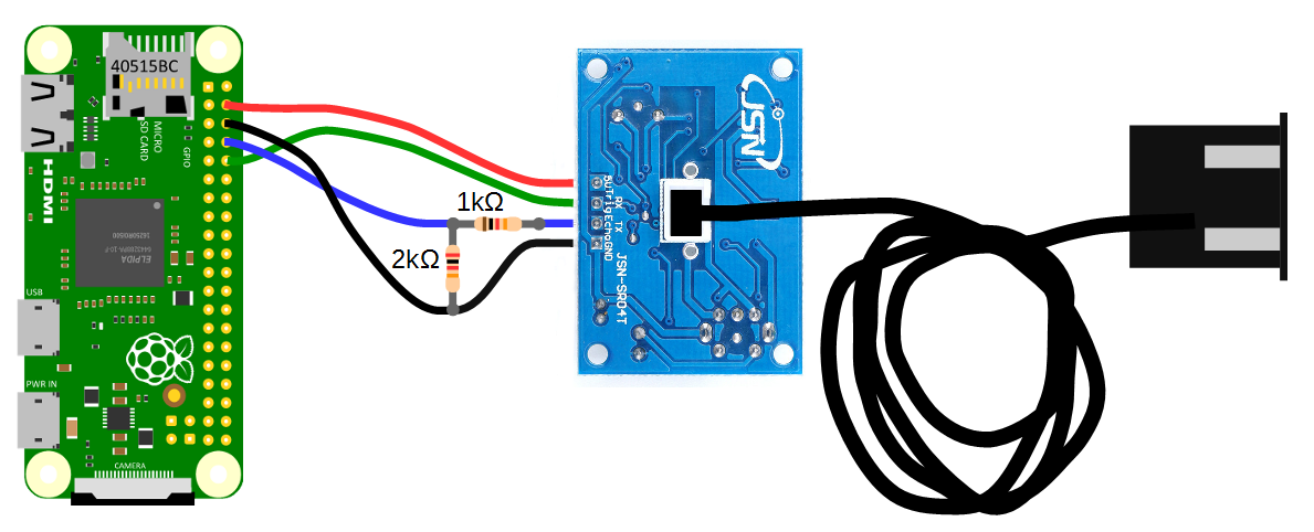

4. Setup the Breadboard:
Actual Breadboard setup used for Tutorial:
PIN 4 is used for 5v Power
PIN 6 is used for ground
Distance JSN-SR04T Sensor
1 and 2 ohm resistors
GPIO_TRIG= 24; // PIN 18 = GPIO 24
GPIO_ECHO = 23; // PIN 16 = GPIO 23
LEDs
330 ohm resistors between GPIO and LED
GPIO_GREEN = 17; // PIN 11 = GPIO 17
GPIO_YELLOW = 27; // PIN 13 = GPIO 27
GPIO_RED = 22; // PIN 15 = GPIO 22
For more information about Pi LEDs see: Basic GPIO Control on Raspberry Pi Zero W – Blinking an LED
Below is a JSN-SR04T diagram that provides more clarity than the photo above. The tutorial breadboard used different GPIOs than indicated in the below diagram. See GPIO_TRIG and GPIO_ECHO above for the GPIOs used in this tutorial which are required for the gspi code to work successfully:
Pinout for Raspberry Pi Zero 2W:
5. Power-up the Pi
6. Startup gspi service:
- The gspi service will already be running after power-up if sudo /opt/gspi/gspi.sh install was run earlier
- If it is not running, run in console mode: sudo /opt/gspi/gspi.sh console
- Check for exceptions in the console or in the log: /opt/gspi/logs/gspi.log. Warnings are OK.
- Watch for errors within GS System Notifications in your organization. Click the envelope icon in the organization Observation Studio toolbar.
- The operating range of the JSN-SR04T sensor is 25cm to 4.5m. Resolution is 0.5cm. Move the sensor around and watch for the LEDs to change as the distance changes.
- You will see the new distance stream automatically appear under the Component:
1. Select the component to get a Quick View (2) of it
3. Double click the distance stream to view, graph, or edit its data (4)
Congratulations! You have successfully setup the JSN-SR04T sensor with LEDs.
